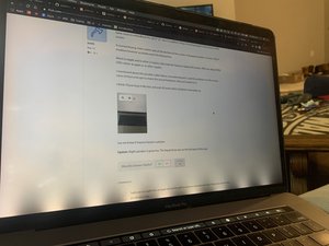

Black shadows from the bottom of the screen
I bought my MacBook Pro 2017 in September and after a month or so of use I got my display like in the photo. I called the support and even after all of the possible "software" actions they can't solve my problem, so it appear to be hardware related.
Anyone has something like that? How they solved your problem?

You need to get your system repaired under warranty! You have a backlight driver failure or the backlight within the display is bad. Did you speak with Apple directly? I find it hard to believe they lead you astray here as this is such a new system.

They told me I have to take the Mac to an assistance service it is under warranty and I did nothing to damage the system. This problem doesn’t occur every time I restart the computer, sometimes it takes a week to appear again so I will have to give the computer until they see it with their own eyes the screen like in the picture. The guy told me it can take even e month or more! So I’m trying to find more experienced support. It is so frustrating, I work with my mac and to have no concrete support after one month is incredible.
Do you know I can I stress the system to make it appear?
The best thing you can do is take a movie (or pics) using your cellphone place them on on your system on the desktop so they can easily be found. Make sure all of your stuff is copied off (backed up) and remove anything thats too personal.
I hope you have not only your purchase paperwork but all of your visits documented to whomever you spoke to. The more paperwork the better here! Make sure you have copies to give to Apple
Once you have the evidence go to an Apple Store (make a support appointment) and ask to speak with the service manager so you can show them the issue. They should give you a replacement system. As this is a manufacturing defect.
As how to force the system into this state I suspect it maybe heat that will push it. I would first install a good monitoring app like TG Pro you'll need to full version here at you want to enable logging. What you want to do is keep a clock nearby so you can take note of the exact time the event happens then review the log file to see what sensor is running hot.
To push the system you could try blocking the air ducts just don't do it too long here. And, you'll want to run something that pushes the CPU & GPU hard.

After so many days still I have not received a decent support by Apple. They keep on telling me that I have to wait, or to take the MacBook Pro to a service provider and when I do so they call me back to tell me that the engineers have not reached a final decision and that I have to take the computer back until they decide. This is more than frustrating, never imagined that apple care was like that. I posted a video of my problem: https://www.youtube.com/watch?v=g6cRdY4q...
In the end they changed the display. There is no way to spot a single component failure, they had to change it completely.
Wow I just had the exact same issue on my MBP Late 2016 with Touch Bar now. This must be a common hardware issue with some of their Late 2016 batches as the pattern is clearly there. I'm just 2 months out of my warranty and guess how much they quote me to fix it? $600. We already paid top dollars for this supposedly premium hardware. Shame on you Apple! They had battery problem right from the beginning with this model but I decided to stuck around to support them. They would be crazy if they think they'll get more money from me. I'm moving to Dell XPS.
FYI, I just got mine fixed at a Macbook repair shop in Saigon, Vietnam (big shout out to Laptopblue.vn or Applefix.vn). The most amazing thing was they found out that only the display cable was damaged, absolutely nothing was wrong with the LCD screen itself. They did a great job and my screen is working as good as new again. The cost was $50.
Prior to going to this shop, I went to two Apple Authorized Service Providers and they both wanted me to replace the entire display assembly as some of you here had encountered. I suspect this was a strategy employed by Apple to extract more money from their loyal customers. Shame on you Apple!!! I will never buy another device from them ever again.
I know some of you may encounter this issue in the future. You don't need to replace the LCD, you'll just need to fix the display cable. Don't give Apple $600 of your hard earned money. They don't deserve this.
