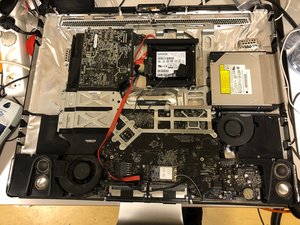

I have a 24” 2009 iMac that I’m trying to replace the original HDD with a Western Digital Blue 250GB SSD.
With the SSD in an external case the iMac sees it just fine and I was able to install OS 10.11 on it and even boot from it that way.
When I install it in the iMac it won’t boot from it at all. I just get a white screen with no flashing question mark??
After further research and tinkering it turns out I needed a new Sata data cable. Apparently it provided good enough signal to work with the slower data rates of a hdd but not a new SSD. Hence the red cable.
I will do a better job of rerouting and installing when I’m ready to reassemble but yeah, new cable...

i had the same problem and abrixen's fix worked for me too:
solved problem:
24" imac 9,1 won't boot from any ssd if connected to the hdd bay cable
symptoms:
the screen stays white if the ssd is connected to the main sata port, where the hdd used to be.
no apple logo, no question mark at boot.
no option boot menu possible even if another bootable drive is connected to usb.
no option boot menu even if a bootable cd or dvd is inserted
fix:
just like @abrixen i took a standard red pc sata cable with a short straight plug on both sides, to be sure the bezel will close if it is plugged to the mainboard
reason for a short straight plug instead of an angled sata cable was, that any angled sata cable i could find had the angle pointing in the opposite direction, so if connected to the board it would point towards the wifi module
(a supermicro sata server cable was the one with the shortest straight plug i could find. almost as flat as the angled plugs as you can see comparing the original sata power cable to the supermicro sata data cable in the picture below)
to save time i didn't bother to route the sata cable below the main board, as it was so thin, that it fittet between the cooler brackets and the display and the temperature seemed to be the same to less compared to the heatsink side below the board, so if it is routed as on the picture the imac display will fit cleanly with no more pressure from below as the pressure the sponge spacers apply without an additional sata cable.
