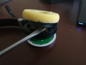

One should NOT attempt to pry of the sides. They will come of, but you will destroy the threading of 3 screws.
What you want to do is find a flat screwdriver or similiar and press on one side of the hinge. (the front one if you keep the mic on your right.
I hope it is visible that that can be pushed out.
If you pick the wrong side (like me) you'll break the little bit it pivots over.
Should you succeed you'll have fine access to the innards.

Both hinge pins are quite long and look like this:
They fit into holes in the ear pad / speaker assembly. I wouldn’t worry though which side you disassemble first. Though the hole approximately opposite the power switch looks easier to slip onto its pin:
It appears both would be equally difficult to disassemble:

Thanks @fff666 @fizzyelf @verynerdy - all very helpful. I'm trying to pry open the main ear to replace the battery.
A further guidance on how to slip the pin - do you just push (very?) hard with a flat screwdriver against where it hinges? Any angle to apply to slip it? Pull or push up at the same time?
Have done some initial pushing but not no movement - worried to apply too much pressure in case break the hinge. lastly, if break the hinge, is it not very usable?
Thanks
Yes you need to press really hard. I pushed on the side the opposite the led lights and it worked well.

At least for the left ear there is an easier disassembly possible!
1) remove the side (its only connected with three clips). NO screws here (Jabra Evolve 65).
2) use a small screw driver to lift the hole over the pin (see details above) but do so by accessing the hole through the openings now accessible form the outside (see picture)

I successfully opened the mic side of my Evolve 65 and re-soldered the wire which connects the non-mic side speaker to the circuit board. I used the tool in the picture below to push in the tab which connects to the pin.
See the tab in Picture #2 from Fred Fierling @fff666. I can confirm that this tab is on the "the front one if you keep the mic on your right" as Christian Kjaer @fizzyelf said. I think it would be pretty hard to break this tab by pushing it in because it has reinforcement on the backside. If you pull the earpiece as you push in the tab, it will slip off when you pushed the tab far enough.
