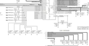

I recently purchased a water damaged iPad mini 3, after looking at the iPad under the microscope I can see the lcd connector, and roughly 5 of the sourounding capacitors/filters are visibly damaged.
I’m looking to replace these damaged parts, but can’t find any schematics for the mini 3 to find out what bits I need to order in,
Does anyone have any idea what the sourounding components are please?
I do have a picture I can email over also to help pin point which ones.

That shows the damage done
Yeah, I can't find anything either on ZXW. Perhaps if someone has FiveCore they can confirm if it's on that platform. I would post the picture so we can all see it.
Based on what I can see within ZXW, the mini 2 and mini 3 appear to have identical LCD connectors and layout. I have attached a screenshot of the mini 3, which has no parts identified and the mini 2 which does. I would refer to the mini 2 schematic for all of the component specs.
Not ideal but this is probably as good as you'll find. Good luck!
Funnily enough i have just been having a look at a mini 2 board I have here under the microscope compairing the two.
But that helps a lot more, so thank you very much for that! Now I just need to hope they have the same components, will get some ordered and try it though!
