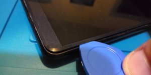

I dropped and damaged the screen of my Hydro Reach and determined that I need to replace the LCD digitizer. I found one on ebay.
But I have NO CLUE how to go about actually assembling that if and when I order it. When you open up the back of the Hydro Reach, it is fully covered with only access to the SD and Sim cards. The battery is enclosed inside. So, there's no obvious screws with which to open up the back.
I've searched high and low for guides on this specific phone and have only found ones for the other Hydro's that do not have this enclosed design like the Reach.
Please help!
Well, I don't know if you're still needing it. With the Hydro Reach, you need to remove the screen assembly first. Much like the J series Samsung messaging phones. Under the screen are the connectors for the digitizer and LCD with no brackets, so it's pretty straight forward. Once the screen is lifted, the connectors are long flex cables that plug into the board at about the mid point, halfway down the device so you do have a bit of wiggle room to get the screen up and unplugged. Then just plug in the new assembly, adhese it down, and you're good to go!
This is a pretty worthless "answer". Yeah, we need a straight forward screen lift.
He start off by applying heat around the screen of the phone to loosen up the adhesive. Next step is to use a tool preferably plastic to pry between the screen and the phone and slowly slide around the phone to release it from the adhesive. A small suction cup helps to pull the screen up as your prying. It should come off pretty easily just be gentle and go slow. Before you pull off the screen make sure to disconnect the two connectors. Hope this helps.
Your general answer was cool and easy to comprehend, but I need more specific detail on how to remove the screen assembly. I see NO APPARENT way to lift or remove it. I don’t want to damage my phone. Simply need to get to the charging port so I can replace it. Can you or anyone else help. Please! Pastor P.
I got a Kyocera in an Ebay lot, and it has a display problem. I would suggest heating the device to loosen the adhesive, and use a suction cup and prying tools to lift the display panel. The only thin different about my Kyocera is that my display was completely broken, and the display was already lifted away from the frame of the phone.
