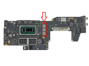

UPDATE
To the Mods: Please do not add this to the first post of this thread as this should be a seperate post and it should have it's own comments
So my multimeter came today and I meassured these tree Inductors (bellow marked in red) and they are shorted to ground (both diode mode and capacitance mode verrified this). Is this normal? As the other inductors for example show a reading and do not beep for example in diode mode.
They are located here on the logicboard next to the heatpipes:
I hope this doesn't mean an dead cpu :( This was a quick measurement but I also meassured some other inductors and they all had a reading. I haven't meassured the backside yet too as I'm short in time but I will update it here.
This line goes to the CPU, which is naturally low resistance to ground.On this board, it usually measures around 5-8ohms resistance
@reecee oh okey, but my multimeter showed 0.00 so I am still thinking it is shorted or is it just out of the range?
If it's in range, it shouldn't be that low. Inject 1V or less on this line, and if the CPU is getting hot, it has a short inside the CPU (i.e., it can't be fixed)
@reecee Thanks for the reply and sorry for the late reply was really bussy. I never injected voltage somewhere so I am not sure where to inject it the best.. Do you have skype or something? I will soon meassure what the other macs inductor in the same place outputs so I can compare it with the dead logic board..
Just inject a low voltage (nothing over 1V) at this point, and feel around to see what gets warm. Put a bit of isopropyl over the CPU, and an area of it will evaporate after a bit.
I have a reference board for this model and before replying to you, checked resistance at this point; it is not normal and is far too low
