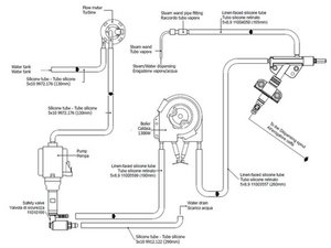

Unit comes on, when ready to force water through the pod, the unit sounds like it goes to half power. Made sure pod isn’t too tightly packed. Regularly descale the machine, hoses are clear, unit is primed, just very little water pressure. What is the issue?

@shammond86 you definitely want to check all parts for obstructions caused by debris or buildup. If all that looks good and is clean you need to consider bad hoses or a pumps issue.
shows a typical water circuit for the Gaggia
