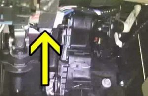

cant find the plug to add a trl elec. brake box.have tore the dash apart ere dealer said was were the plug from factory and the directions say called curtise and not on back of box in dash????
you are right.it was taped to a harness behind that lower panle
thank you very much
@brad1 your F-150 will only have that if it was factory equipped with the trailer towing package. You should find it next to the computer under your dash as shown here
