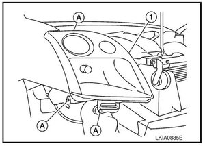

2011 sentra headlight assembly replacement
how do you replace a 2011 sentra headlight assembly

@acguy3 I always wonder if we can build things more complicated ;-). Per SM you need to this :
Removal and Installation
REMOVAL
1. Remove front bumper fascia.
2. Remove the front combination lamp assembly bolts (A).
3. Pull the front combination lamp assembly (1) toward the vehicle front, detach the harness clip, disconnect connector, and remove the lamp assembly.
INSTALLATION
Installation is in the reverse order of removal.
• After installation, perform aiming adjustment.
