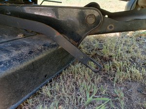

@oldturkey03 You are super helpful! We have the same exact problem. We checked your first suggestion and that doesn't work. We noticed this dangling underneath. Do you know what this connects to by chance?
@tammym47481 interesting......what make and model is your mower? Can you zoom out and post an image of where this part is located, in reference to your mower as a whole.?
