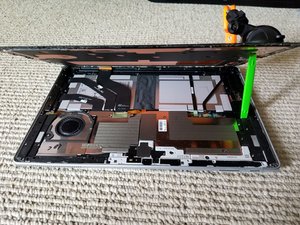

I have just removed the screen from my Galaxy Book 12. It wasn't too difficult. The attachment method is very similar to a Microsoft Surface Pro 3 or 4 so you could look at some youtube videos of those to give an idea.
The screen is only attached with heat sensitive tape. I used a heat gun, razor blades and a plastic pry tool. It would be best to only pry on the top and sides, not the bottom as the join is narrow there and the LCD ribbon cables can easily be damaged, as I did. Didn't matter in my case as the LCD panel is broken.
If you can get the top and 2 sides separated then you can just use leverage (and some heat) to separate the bottom. Then detach the LCD and touch cables from the mainboard.
It appears to me that the glass digitizer is quite strong but the LCD panel is very fragile. That is the opposite to a Surface Pro where the glass cracks very easily but the LCD usually remains intact.
Some photos;
Despite much searching I haven't been able to find any source for a replacement screen assembly for a Book 12.
However from searching with some of the part numbers that are exposed after opening the device I am reasonably confident that the whole screen assembly is identical to the previous model (Galaxy Tab Pro S).
I haven't found a reasonably priced replacement screen for that model either but at least there is more information available than for the Book 12.
If anyone finds a source, please post here.
Cheers

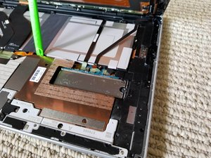

Here is a comparison between John's teardown pic and a picture from a Samsung launch video; you can see where the m.2 SSD lives, and it seems to be the 80mm long variant. I'm going to try to pry mine open and swap it out.
Update (06/20/2018)
I went ahead with the disassembly, mostly successful. I was able to open it up and swap out the SSD, I went with a 500GB Samsung 860 EVO and its working great, I'm typing this on the machine right now.
The downsides are that I can probably never sell the tablet now, and it looks a little rough around the edges now. The heatgun actually slightly melted one of the plastic vents on the side, but its not a big deal. The bigger deal was that the gun seems to have slightly warped the metal frame, so once I got the screen off, I realized that the power butten seemed to be stuck in the on position, and couldn't get it to pop back out. The volume buttons were fine. I realized that the slot that is cut out for the powerbutton had compressed and shrunk, so the button had no breathing room to move. I stupidly tried to re-expand the slot with a screwdriver, which is why I have all these little indentations around the power button slot. I ended up having to take the button out, and use a dremel to shave off a little of the side of the power button, once I did that it was fine.
I didn't see the memory inside anywhere, though most of the components are covered by the heat sink.
I'm guessing the memory is probably soldered on to the board anyone. I was hoping to find the wifi card so I could maybe swap that out, but couldn't find it.
I assumed I would have to buy some sticky adhesive to put the screen back on, but I just pushed it closed and it seems to be staying that way. I did notice some pinkish discoloration along the bottom of the screen, but it seems to be gone, so it either self corrected or I imagined it.

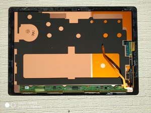

Here is the part number for the LCD for the Book 12.
GH97-20448A
