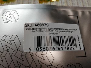

I tried the pencil trick on the contacts, but didn't work. Finally I bought the conductive film replacement and it's all back to life. I had a hard time finding some in stock in the usual Chinese websites (like being informed two months after the purchase that there was none in stock and I'd be getting a refund). Finally I found one, allegedly shipped from the UK, on a website called fruugo. Attached are the photos of the product.
Note: this specific SKU in the photo is for the DS4 v1. Pay attention to which model you have (v2 shows the LED through the TouchPad)

This was the same with mine - use a multi-meter (set to ohm or kilo-ohm) or another continuity tester to check contact between the black contacts which should be connected together by the line traces on the keypad membrane (film). On my DS4, there was a break between the left half of the 'down' pad, and the bottom half of the 'left' pad, as well as other breaks in the same area (e.g. top left trigger was unreliable).
The fix is a new membrane. You must get a membrane which matches the white part-number printed on the mainboard of your DS4 (in my case this was JDM-011). My cost for this was about $/€3 (locally posted in Europe), or about half that if posted direct from China. Search terms I used were "DS4 film" but you could also try some of: ps4 playstation4 controller membrane.
Double-check motherboard version, but I think these are also colour-coded (JDM-011 is green).
