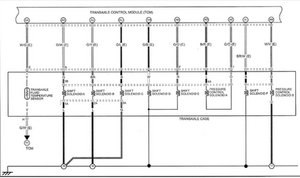

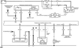

@techmanphil lets find out if this is what you are looking for. Here is the connector and where the wires originate from
Update (10/03/2017)
@techmanphil sorry do not have anything in color. What I do have is the diagram with the marked colors. i.e. connector AC color W/R (White/Red). Hope this will work better for you.
still really what color wire goes to which pin pinout omg i wish i would of took picture without all the reasearch isnt there a easer diagram btw your the only one who has took the time for me im indepted to you
@techmanphil okay got it. You need the colors to attach the wires back to the connector. Let me see what I can find in the wiring manuals. Bear with us :-)
ok thank u so much techmanphil63@gmail.com u can send at email mr oldturkey03
@techmanphil check the attached images ;) Those are the ones that have the the color codes for the individual wires that attach to the TCM
