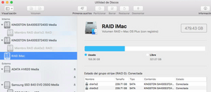

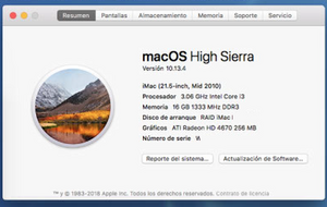

Hi,
Just to tell you that the clean installation and update on a 21.5” iMac Mid 2010 (11.2 ) with x2 SSD Kingston SSD’s in RAID 0 16 GB RAM and has worked perfectly with the MacOS High Sierra Patcher Tool for Unsupported Macs, using HFS+ (not APFS)
We have tried it as a resource since High Sierra does not allow to install APFS on RAID volumes. Just Use: http://dosdude1.com/highsierra/
Excellent day!
