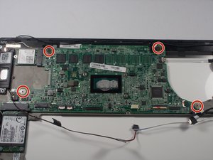

Sorry to say the click series has soldered RAM as you can see here:
So no you can't upgrade it from what it was shipped with.
