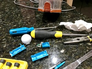

I’m having the same problem, but cannot figure out how the spring fits over the x. Could someone please post a picture of their spring setup?
. Here is my spring, for reference.
Hi, I had the same question but it turns out I was over thinking it. It just means that the X kind of marks the location on the plastic doohickey. Just place it across (above) "x" and squash shut. Its purpose is to widen space so that latch stays closed, and also provide enough give so it can sproing open.
Did you manage to fix this Leslie? I have the same problem and the same spring as you show in your photo. I can't see how the spring fits.
Thank you for all , all the info was very helpful , as I too lost the spring when the vacuum tips over. To get the spring fit over the cross I widen the spring top by stretching the few wires with a small jewelry pliers and it worked.
