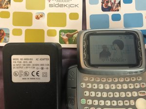

I just got my Sidekick Color plugged in and charging for the first time in YEARS. The charger that is working is
DC OUTPUT: +5V / 1.5A, with the positive in the inside of the barrel connector.
Silly me. I went to the box, pulled it out, saw the (useless) USB cable, plugged it into USB power and was disappointed when it didn’t charge. HAHA. USB charging is so 2010! This is a 2003 device.
