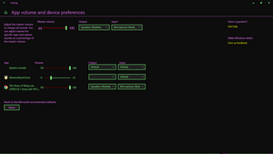

Finally, I found a solution for Audio in chrome not working in Windows 10
Step 1
Settings > System > Sound > Advanced Sound Options (App volume and device preferences)
Step 2
In the next screen > Master Volume ===> Make it 100%
App > System Sounds ========> Make it 100%
Google/ Chrome > System Sounds ========> Make it 100%
This should work now.
Above steps has to be made in your system and not in the browser
You can view the screenshots here...
https://www.guidingtech.com/fix-google-c...
