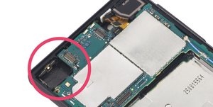

Where this part should be attached?
While Teardown, this part fell from device but I don't know where this fell from.
Tell me where this should be attached!!
I can't install any other part.
Sorry for bad English.

This part goes behind the logic board and back camera, it acts as a grounding clip.
Pretty easy to reinstall, just a little bit of a pain that you'll have to take the logic board slightly out to reinstall. :-)
life saver, I could not figure this out
