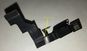

Recently changed the battery in my phone and now the rear and front camera, the flashlight and the earpiece do not work.
What do u need to replace to fix this problem?

I have opened the phone up. Disconnected the front camera connector. Turned the phone on and the rear camera and flashlight now works.
Upon connecting the connector again I found that the rear camera and flashlight still works while the screen is not seated but upon seating the screen down they do no work again
Something must be shorting out but can't see it
Exactly as I found. I'll try a new assembly, but my current one looks fine.
This worked for me too when I replaced the fcam ass.

Just replaced the FCAM ass.
Success!! Everything is back to normal.
I'm not sure why exactly exchanging batteries made the FCAM ass. fail in two identical situations, I can only assume it was because OP and I didn't think to remove front screen entirely and it was damaged in the process.

Replaced Front camera assembly and success! Front camera, rear camera, flash light and earpiece now work perfectly. Thanks for the help. SOLVED

That is odd. Those components are on three separate flexes and independent drive circuits on the logic board. The only common denominator I can see is some pry damage that occurred when you removed the screen connectors. Those connectors are surrounded by tiny surface mount components that are part of the circuitry for the cameras, flashes and the earpiece.
You will need to open up the phone again and do a thorough visual inspection, preferably with magnification. Look for partially or fully dislodged components. If this is indeed your problem, then this will require a micro-soldering repair and is not DIY.
You could also try to do a full DFU Restore first (backup your data!) to eliminate any potential software or corruption issues.

Sure, both the the FCAM and the RCAM get their power from the same source (PMU). So if one is bad, it can put the PMU in current limiting mode and cause both cameras to fail or in a worst case scenario, even kill the PMU.

Well, I think if you dropped the phone, and the display popped off a little then maybe, but im my situation the flex cable ripped causing a short to the front camera. If the display popped off then you could have a micro tear in the flex. I would replace the camera flex, but test by taking off the front camera flex at the connection and see if the flash starts working again, and if so; you have a bad flex!

It’s been a long time since I had this problem, but check that flex that is posted about. That was my issue. Make sure you have the flex connector snapped properly! They are kinda hard to seat, so that’s where I would start. Then I would buy the cable I talked about in the early post.
I replaced my battery and ended up with the same trouble. Later, replacing the front camera assembly fixed my phone. The ribbon ripped in the sharp turn, apparently when I initially opened the phone. Thanks for all the input.
BTW the picture of the ribbon was taken by my repaired iPhone 6s Plus
