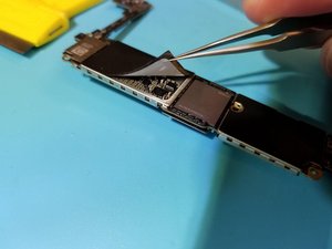

In my experience the most common cause of a bootloop an an iPhone 7 is the Audio IC chip… or rather the lack thereof. This chip will loose some of its solder joints similar to how the touch IC would on the iPhone 6 plus.
Here are some images showing where it is and how to get to it.
The only real way to fix it is to remove this chip, re-ball, and re-solder it back. This does come with some risk and should only be done by an experienced professional.
