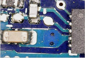

Need help with Identify of burned IC U1600 on Apple Airport Extreme A1143 MB053LL/A main board 820-2214-A
Help please!
Just need a Hi resolution picture of U1600 area on main board to identify IC.
Thank you in advance!
Here is pictures to understand what I'm looking for -

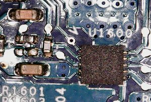

This IC U1600 is a LOWPIN COUNT SYNCHRONOUS BUCK CONTROLLER TPS40190 by Texas Instruments,here is link to PDF datasheet
Also here is a picture as it must look if IC not burned as yours -
