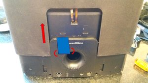

It was impossible to find information about how to open it .... After a analysis of the box much searching the I managed to open it and I'm putting photos of how to proceed. You have to put a protection so as not to hurt the protective cover and to move a cover with a screwdriver inserted in the holes ... I hope the photos help because it is difficult for me to explain in English the procedure. Power supply completely damaged... several components ....
See image content

Insert something thin and wide between the fabric cover and the hard plastic above the bass hole. SLOWLY draw them apart being very careful to not damage the fabric cover. Don't go more than 3 cm, there are 2 thin cables attached to the cover that need to be taken out of their connectors.

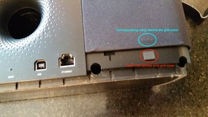

I came across this post by Marcos Sliva and it took me a while to comprehend the procedure of separating the grill fabric cover and the main chassis. It did help me to take apart the my unit and I thought I could help to expand on his post.
The grill cover wraps around the main chassis and it is inclusive of the brushed metal piece on top, the main chassis is everything else beneath. As Marcos Sliva post, begin by removing the rubber feet surrounding the unit.
Next find something similar to guitar pick and insert in between the catch holding the grill fabric cover and the main chassis. There are a total of 4 catches located in front and back of the unit. Then place the unit front side facing down, it would help with the next step.
Find flat wide sturdy tool ( I used a metal ruler) that can slot in between the fabric cover and main chassis, the position is located above the bass port(hole). With the tool in place, turn clockwise or whichever way to separate the cover from the main chassis. Move along the seam and gradually separate the two parts taking copious care not tear the delicate fabric cover. 2 parts can be separated easily when gap is sufficient to use fingers , taking care to disconnect the ribbon cables.

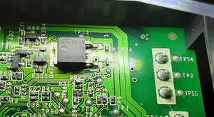

I still have a problem and a photo, I will get to that. The symptom I have now is, with the A7 assembled, if I try to power up there is no response (no LED) but if I hold the power button and apply power then the LED is solid white, for a functioning A7 that means firmware update mode. The unit does not respond to any attempt to connect with a MAC or PC, however. Still maybe it is progress.
I am working toward replacing some/all of the SMT electrolytic capacitors and while inspecting I thought I could possibly see some slight bow on the top of one cap on the DSP/Amp board.
On the underside near the suspect cap I found a damaged SOT-23, Q45, marked “W3K”. Note the tiny crater where it should read 33. I am going to remove both Q44 and Q45 to try and identify the part so I can order some. I have searched online SMT part marking lists and found diodes with “W3” but no “K“. I will draw a schematic of that section of the board as well for grins.
Does anyone have a clue what cheap SMT SOT-23 part was marked with “W3K“ circa 2014?
@sunnyjim : This should be what you are looking for,
https://assets.nexperia.com/documents/da...
W prefix for part that is made in the china factory. Marking is 3K.
Hope this helps.
@pukiima That is awesome I totally did not expect your rapid response, many thanks.
Unbelievable a $0.40 PNP transistor fixed it. Maybe the power supply board did have a problem as Q45 obviously overheated and it is involved in supplying 3.3V to the DSP. Thanks again for the incites everyone.
