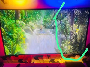

My samsung curve had the horizontal shadow about 1/4 of the top of screen. Tried everything and nothing worked until I tapped the back bottom portion of the tv and the shadow went away. Any idea what could be loose?

Who know why my Samsung 55 curved one side looks faded color
I have the same issue on my 70” Samsung, any luck?
