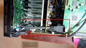

I just fixed mine with the same issue. The holding of the Advanced Surround button and Power button for five seconds reset the error, but a few seconds later it came back. So I ended up opening the unit up and replacing the short little HDMI cable connecting the front input board to the main HDMI board. This fixed the problem. Seems the way it was twisted in there damaged it over time and it needs replacing. Everything works as it should now. My model was a VSX-1023.
@mchico33 Is that a type of cable I can find on Amazon or do I need to find a specialty store? Josh
Josh,...these are tricky HDMI problems to trace down. The cables are one possible cause - but you have to experiment to figure out which cable... or no cable and its something else. So before you do the expensive cable replacement approach, try pushing the existing cable on to the top internal upper board edge a few times. Does it seem loose? If that's not loose, it can easily be a cable at the back of the machine that is loose and causing the glitch. Try new cables back there if you have those installed. If you take them all off in the back... does the problem go away on a Reset? Good luck!
Josh, you can test this with any HDMI cable you have around the house. It doesn't have to be a very short cable just to test things out. They are standard connectors inside the receiver. If this fixes your problem you can order a short little 6-12" HDMI cable from anyplace online and just swap that in. Just try and avoid a cable that has a thick cable cover as part of the cable may have to lay into slots in the electronic boards in the receiver, and they can be a tight fit.

Can you show me a pic of the Cable you are talking about
Thank you for the great info. Tried the reset it worked for around 4 seconds then it would fail again. Tried a few more times same result. Took it apart and pulled out the short HDMI cable. It looked fine. Blew out the inside of the unit and the cable connections. Reconnected the cable turned the unit on and it's working now. Thank you again.
Unbelievable!! The Auto Surround+Power worked on my VSX-44! I thought the front panel was dead and was planning to take the AVR to the E-waste recycling center. It's only been a few minutes but so far, so good, and I'm going to go ahead and replace the inner HDMI cable while I have it open.
I'll post a photo of my VSX-44's inner HDMI cable below if anyone wants to see.

My VSX-44's inner HDMI cable:
@davidhanna76275 Most likely no longer helpful for your issue, but may help someone down the road:
I have a VSX-44 and none of the above tips worked for me. Same issue...pressing the power-on and Advanced Surround at the same time clears the error for a few seconds but then reverts back to flashing HDMI. I tried removing the inner HDMI cable and replacing with two different HDMI cable that I know work and had the same issue. Any additional tips would be appreciated. Thanks, JV
I just had the same problem on my vsx -329. Thank you for the advise on here. Also gave my receiver a little bit of tlc as I have had it now for almost 20 years.
Its the one with the 5 black wires and one white wire
what is name of the cable? how can I buy to replace for my receiver?
