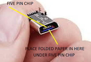

hey bro I have austrum wireless headphones. its charging the first I had it, but on my way back home it couldn't be charged. idk what happened. can u tell me? its aastrum wiresless sport headphones.
Wearing your wireless headphones while charging, especially when in motion, can cause damage to the charging port. Check to see if the central five pin chip inside of the micro USB charging port on your headphones is loose. Use something plastic like a plastic fork tine to see if it wiggles inside of the charging port. If it is in fact loose in there, you can stuff a very small piece of paper, about 1/4 inch by 1/8 inch and then folded hot dog way, under the five pin chip to push it up, and when you plug it in *carefully* and use a little force to get it all the way in, it should be able to make the connection to the five connection points on your micro USB charging cable tip. Cheers to cheap fixes. I just did this to my headphones and they are currently charging away. Good luck.
