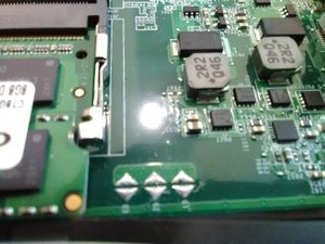

Unknown Factory BIOS Password, Cannot Access Computer
Laptop: Toshiba Satellite S55t - B5260
MOBO: DA0BLNMB8D0 rev D
After replacing video cable to a fix black screen issue on a friend's computer, laptop boots, then says 'System time and date reset', then asks for password. I asked my friend about the password, and he says he never set anything to his knowledge. After 3 tries system shuts down. No CMOS battery is easily visible or related markers on MOBO. So 2 things:
1) Why did the time/date get reset?
2) Does anyone have ideas / experience with this model family or similar? I haven't found anything specific to this model on the internet so far. I've got a few shots of the mobo if someone can pick something out. I've found a few 'tips' on this sort of issue on the web, but a lot of it is fairly old or does not specify when it was posted.
Any ideas are appreciated, this is incredibly annoying to be locked out of the system by the maker (apparently)...

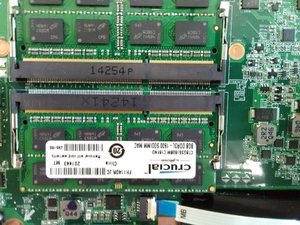

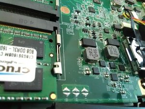

For those without a magical 4 space password you can short G2 with a paperclip while booting up.
I'd like to try this. Can you explain where to find this G2?
I'd appreciate it.
Thank you
Well, for the Toshiba S55t-B5273NR, which has the Quanta DA0BLNMB8D0 motherboard, G1, G2, and G3 are located by the ram slots near the edge of the board. If you are facing the board looking at the ram slots it will be down and to the right, down and to the right, near the edge of the board. I added pics to my original response. G1, G2, and G3 each consists of two silver (soldered) arrows pointed away from each other. They are in a row and G2 is in the middle.
Shorting the G2 pins, looks like sets of <> together worked for me. Thanks Ken Computers.
S55t-b5273nr
Worked great shorting the G2 pins. Thanks a million
