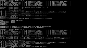

Tricky for the novice because of the text based Linux interface. It requires you to read and think. If you can handle that, it is perfect.
 What it does is remove the encrypted password so it is like a new system.
There is a program called "ntpasswd" it wipes any users password, admin or not, on Windows NT and up. You just need another computer to burn the program to a flashdrive or cd and boot it up like any OS. I've used it many times on computers that people wanted me to fix, but forgot their passwords.
It is terminal/command line based but fairly straight forward and easy to understand.
