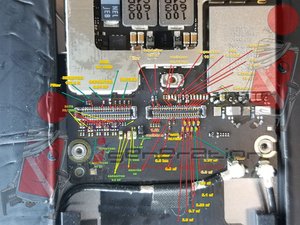

Anyone got back light schematics?
Looking for schematics for ipad pro 12.9 back light or anyone know where the LCD back light filters are located

@danb89 here is the only thing I have thus far. Hopefully more to come in the near future.

has some1 find a more detailed iPad Pro 12 schematics?
i need to buy some replacements for the coil and the data filters, but without specs is not possible :(

None available at this date and time. Your best bet is to look for the similar circuit in an iPad Air 2 and spec up if you think it's necessary (i.e. a pro 12.9" backlight circuit will probably need higher rating filters).
the capacitor next to the touch filter. You sure its def 2.0nf and not 2.0uf?
Yeah, I'd also like to know if it can be found on an iPhone 6 mainboard, like with the filter. I need this one, I got the filter down, but have no clue as to where I'd find this - and thus it'd be easier to pick off a mainboard..:) thanks in advance!
But why no schematic for those iPads ?
