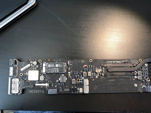

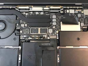

Are these 2 MOSFETS the same value?
MOSFET A = 5:26
MOSFET B = 6:33
MOSFET A is from an 820-00165-A
MOSFET B is from 820-00875- 1
Any help would be greatly appreciated.

Which model is it? Board number or screen size and year? Where exactly are they located, have you got a picture with a larger look of the board?
@reecee - The upper is from a Early 2015 MacBook Air 13″
The lower image is from a Late 2016 MacBook Pro 13" Function Keys system. Checkout this image: Logic bd look just below the RAM (orange) slightly to the right.
Not sure which system he's trying to fix here.
If trying to fix the 2016 MacBook Pro, I don't have access to donor board or schematic. My assumption is that they are the same but wanted to clarify;
Top one is Q7155 SI7137DP SO-8 Vishay manufactures those and you can get the datasheet from http://www.vishay.com/docs/69063/si7137d...
No way to know 100% due to unavailability of schematics on the 2016 models, but they should be the same component. The last bit of writing on chips or MOSFETs are usually batch number related; it's the first line or 2 which are important
That seems right to me, thank you for affirming my assumption, always nice to have a second set of eyes to look at something. Much appreciated!!!
Yep, they are both the same. You can source them at Digikey.
https://www.digikey.com/products/en/disc...
Here is the data sheet.
https://toshiba.semicon-storage.com/us/p...
