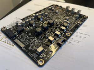

Greetings,
I am looking for some help with my 6-year old ACD. It works for about 2-3 seconds when turned on, then flickers and dies. This happens regardless of whether it is plugged into my MacBook or Mac Mini.
Using a flashlight, I can still see my desktop on the screen, but it is extremely dark. The other features (MagSafe charger, speakers & iSight) are all working fine.
Going through the questions here, this seems like a pretty common problem, however the answers are conflicting and confusing - some people say the logic board is toast, others say the backlight is dead, and I've even read something about the backlight being part of the logic board (what??) which is faulty.
Can somebody please confirm exactly what is wrong, and the replacement part I'd need to buy? Your help would be greatly appreciated.
Regards

Hi ,
I bought an old 24” Cinema Display and it started to having this problem too. When I plug in the display port screen flickers for like a 2 or 3 times and dies off. Speakers and USB ports are working without any problems.
Tried everything and none of the solutions worked for me. And I do not have the opportunity to go and replace backlight. So what I figure out is doing this appears to fix the issue!
  • Plug your mini display port and usb cable,
  • You will not see any image(obviously) set the Display’s brightness to the lowest as possible,
  • Plug out both usb and display port,
  • Plug only display port/after this screen will start to flicker like crazy,
  • Put your MacBook, Mac Mini … etc. to sleep mode,
Wake up your system and you are good to go!
At least this is working for now for me. Set brightness again to what you want it should be OK now.
I know this is an old thread but maybe someone who has this will see and maybe it will work.
Regards.

Hello All, this also has been happening to me where the monitor just flickers starting at 20% brightness. Anything lower seems to be fine, but it is too dim.
So I just recently ordered a used/working logic board and replaced it on my unit. Unfortunately, it is still happening. I doubt it is the logic board, since it is happening on 2 different logic boards. Does anyone have any other suggestions on what it could be? Thanks so much.
Hey! I have the same exact problem that you are having right now and I just wanted to let you know about all of the research that I could find on this problem. As far as I can tell, based off of info from imacs from around this same generation since information on imacs is WAY easier to find, this particular problem was very common and was solely based around a failure in the soldering joints of the LED light strip of the LCD assembly. Sometimes the problem could be linked to a failure in the light strip itself as well as opposed to the soldering. It's inexpensive to replace that strip but apparently a pain to work with since soldering in the amount of space the display has there is very difficult. Luckily, those strips are built into the display assembly itself which means that buying an entirely new assembly would fix our issues! Considering that it's so old now, I struggle with justifying spending the 90 dollars on a new one though. I hope this could add some insight to your problem!
