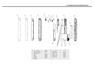

I am needing a parts diagram
Looking for a parts diagram for the LG G Vista (D631). I am needing the front plastic that the digitizer seats on. Want to be sure I'm getting an OEM part that fits right.
misha3267 going by your description you are looking for LG part number ACQ87077611, position 4 in the diagram.
