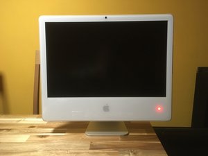

A friend of mine gave me a broken imac 24". I would like to recycle the power supply for another project, however i don't know the pinout, well i could easily find the Vcc with voltmeter. I just need to know which pin will switch on the unit, and if it's a "connect to Vcc" or "connect to ground" system.
Here some more
ref. SADP-220AF (A1200)
24v@4A and 12V@10,3A
A few pics
Cheers!

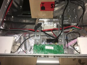

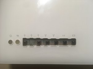

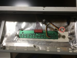

AAaaa I had use the original power button enlarging the cables and soldering to the button of the card.
And glued the led in the spaeker hole ( with cables).
Soon ill upload photos.

If you put the connector of the buttons in this way, you must invert the cables position.

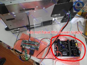

Hi, can I use this PSU with M.NT68676.2 and LM240WU2-SLA1 to make external monitor? if yes then how?
This image is of M.NT68676.2A and I have M.NT68676.2, but both looks same.
M.NT68676.2 Inverter Connection Pins

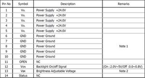

My screen LM240WU2-SLA1's Connection Pins
I want to use Mac's power supply instead of shown in below image:
Can I use it?
as long as you power the LCD controller with the right voltage/amperage, you can use any PSU you like,
i personaly use the same setup and it works well :)
I am trying to do the same thing.
I connected my existing power supply, but cannot seem to get the display to function.
There is an output voltage jumper on the LCD control board. Do you leave it at 3.3V, or set it to 5V or 12V?
thanks.
Yes, you can use the original iMac power supply. I have done this. But with some hassles. You really have a new question here, but the longer answer is to order the board with the correct firmware and cable set for your panel. Then connect the cables as follows: iMac pin 4 to four black wires going to inverter. iMac pin 8 to four red wires going to inverter. iMac pins 1 and 5 soldered to the two black wires going to the controller, and iMac pins 6 and 7 soldered to the red wires going to the controller.

And the buttons to the rear side, cutting "in line" all the imac´s outs.
There are colored caps to enlarge the buttons.
