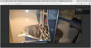

I have had this same problem since I first used it new. I have attached a picture to show you what I do. Wait until you hear the popcorn start to pop in kettle. Use a screwdriver, long knife, or any smooth solid object and slightly pull the screwdriver handle toward you as your metal object puts slight tension on the rod on top of kettle, thus keeping the 2 gears together. This works for me EVERY time. I used to run to the popcorn machine and quickly dig out jammed popcorn in kettle. See attached picture.
