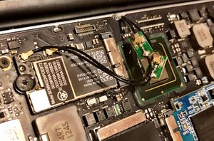

Hi, I've swapped my MacBook Air late 2010 logic board with a mid 2011 one, that fits almost perfectly. The problem is the position of the wi-fi card, that now is too far from the antennas cables, as you can see from this picture:
I need two cables just to extend the antenna cables and reach the card, but I don't know which kind of connectors and cables I need (i think it could be something like male to female MHF4, but I'm not sure of the exact dimension of the connectors).

Ok, I found it.
I needed two cables called "MHF4 plug to MHF4 female PCB with 0.81mm cable".
Here they are:
http://www.ebay.com/itm/MHF4-MHF-4-plug-...
With those cables I was able to extend the antennas, like this
and now everything works fine!

No, Ahmet Can Demiral, as I wrote in my question, I put a MBA mid 2011 logic board inside a MBA late 2010 . Since the position of the wi-fi card on the two boards is different, as you can see in my picture, the cables now are far from the card.
