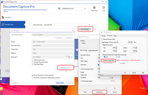

We use the DS 510 in our medical office. The scanner used to scan both Insurance cards and photo ID's with no problem, but recently it jams on only the Drivers License photo ID. I have looked and found no mechanical issues. If we place the ID longways in the scanner it will scan, but then we spend extra time rotating the ID for our files. Time consuming. Any suggestions?
Things I have tried:
Adding post it to the back side of the ID - still jams
Moving the mult page and cont feed button - still jams
crwdns2933315:06crwdne2933315:0
I ran into this too. There's a setting that can detect double-feed (thick document) situations. When the setting is on, cards I scan will jam. If I turn it off, I can scan cards. Good luck!
This fixed it. I created another preset job titled Card Scan Double Sided. I followed the configuration as shown above from Ed. Worked perfectly. Thanks Ed
