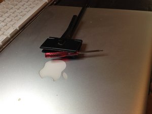

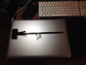

@danj true that it takes a T15 to get those screws out. But that puny drivers not going to do the job! That's a very deep hole! My drivers are over a foot long. I had one custom made back then. One end was the T15, the other end I had a spreader put on with about 2 1/2 " long blades. It inserted into the sides and you squeezed it to spread the case apart. I';; see if I can locate it and post a photo.

@danj Here's my driver sitting on a 15" MacBook Pro for getting into the original Macs.
One end is the torx driver, the other is a case spreader.
@mayer - Well Done!
