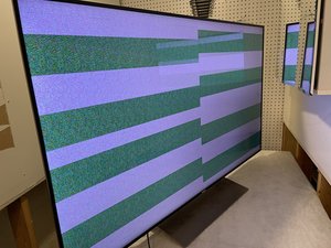

My Sony Bravia suddenly playing green and pink colour. When starting up the screen is green and also has green horizontal lines across screen.

Anwar De Vos this "playing green and pink colour" is usually related to a bad panel. I doubt that this is due to overheating or water damage. Of course you do want to check if this is due to either a connection issues (loose or bad cables) or the source device. Tell us if you pull up a menu, does that look green and /or pink as well. Check all input sources i.e. DVD, HDMI, cable etc. Definitely try different cables as well since there were issues with HDMI ports etc. as well as remove your cable box if you have one and connect something like a DVD player directly to the TV. Also, try to reset the TV to factory default settings. This should work for your set:

There is a chance that this could be caused by a bad T-Con board or a bad mainboard. Post some high res images of your boards as well as what the screen displays. with your question. That way we can see what you see. Use this guide for that.
While the screen shows green and white/pink horizontal bars, it can't show the "reset" on the screen. This procedure does not work. However, by unplugging the power input cable located on the rear side of the screen, on the right, and waiting about 10 seconds then reconnecting it, the TV will reboot and clear the issue.

I just got up this morning and turned on the tv and was met with the green and white strip issue. After swearing for a while I unplugged the tv for a minute and the plugged it back in. The tv rebooted and all seems to be fine. Holy this is not a sign the panel is failing.
Yes encountered the green and white stripe across the screen of my Sony Bravia TV. Simply, I disconnected the power source for about 10 seconds, after plugging it back up the TV went through the settings and returned to the previous settings without any issues. I am wondering if it is an indication a possible issue with the TV, it is approximately 2 years old.

It seems that IF the simple 'power' reset options don't fix the Horizontal Lines on the Sony TV - it is probably the LCD Panel. Replacing the 'cards' inside the TV will not fix Horizontal Lines.
I had Sony tv like that had change mother board of it
Woke up this morning to white and green horizontal lines. Follow the advice to unplug the TV and the TV rebuild. Problem solved.
