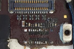

The touchscreen on my iPad is not working. The home button works fine. I have noticed a damaged pin in the fpc connector.
I wanted to ask is replacing FPC connector too advanced for a beginner? I have watched many videos showing how to do it and I feel fairly confident on doing it. Just wanted to make sure.
Any advice would be appreciated. Thanks
Update (04/13/2017)
here is the picture.

I guess that depends on your definition of a beginner. If you have decent tools and a steady hand, it can be done. That said, one side of that connector is very close to a row of small SMD components. It is very easy to blow them away or nudge them or create a ton of solder bridges. As with any micro-soldering reapir, it can go sideways very quickly. In general, I don't recommend beginners try this kind of repair until they have practiced on similar density boards.
Tell us more about your tools and experience.

I admire your courage. The videos make it look easy because they are using 1-2 thousand dollars worth of top-end equipment and/or they have countless hours of micro-soldering experience. Don't underestimate the difficulties. The real challenge is not destroying everything surrounding the part you are trying to fix.
If you use a heat gun, that's what will happen. A heat gun is not for soldering. In order to use a soldering iron, it will need a very fine tip. I highly recommend that you order more than one connector; they melt very easily.
All that said, some folks are natural athletes...maybe you are blessed with fine motor skills beyond the norm. As long as you get into this knowing the risks you will learn something valuable either way.

I understand the possibility of damaging surrounding components but thought I would try covering them with kapton tape. I do know its a lot more complicated than that but I thought I can get away with it.
There's one thing I don't understand if you can help me.
From the videos I watch I understand
First applying flux surrounding the fpc connector and then using a heat gun to detach it.
Then clean up it up with soldering wick
Then they usually move the soldering iron across the pins. What are they doing here? Just before attaching the new pfc connector.
Some videos show them dragging the soldering iron across, some show them using some metal like thick wire, touching it and then applying it to the pins. Also these videos were not ones where they had they had to replace pads and create bridge's. Just to make it more clear as to what I am talking about
For example
5.44 in this video
https://youtu.be/7-n_QjWSYAc
Jessa is not using a heat gun but a hot air station. At 5:44, she is "tinning" the pads with fresh, leaded solder.

This is how things go, sometimes, when you try to desolder components from a logic board....
I want to laugh so badly but im going to attempt this repair in few minutes and I doubt it I will do any better.
@hptl17 take a deep breath and do it. Just know your limits and if you think things are going sideways, pause and decide what to do next.
@arbaman kudos (+1) for posting this. Sometimes our first repair goes super smooth and we think "I got this" but only realize later that it's not that easy. Other times they don't ... :>)
Okay I have taken it off but at the same time some of the pad things come off too. Should I quit now or carry on D: ?
@refectio unless one has a very good teacher, the only way of learning is transferring our knowledge to the unknown and learn by mistakes =:)
hi, what to do when the gold plate on logic board is missing like the picture above?
