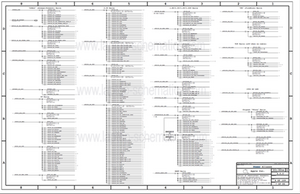

Hello,
I have a Macbook Pro A1278 2012
No led light at all on the MagSafe. No battery charging. What can I do? I tried a NEW battery and it didn't work and I tried a NEW DC-IN and it didnt work also.
Thanks.

The Macbook works 100% fine except that it needs a charged battery cause with MAGSAFE cord it doesn't charge.
I tried BRAND NEW BATTERY. I also tried a DIFFERENT working MAGSAFE
There is no "Simple" answer to this question, you will need to do a deep dive into why there is no power, could be SMC, DATA Lines etc, DO yo have a multi meter?

Important to know the history of the machine, any drops, spills etc. If you don't know the history you will need a schematic, board view and a multimeter and you will want to start test the power rails to see what is and is not present. Once you have narrowed done what power rail is missing you can then begin to diagnose the issue. I have attached the page you need to get started testing start with PPBUS_G3H

I will buy a multimeter tomorrow. However can you guide me just the basics? Then I will go by myself.
