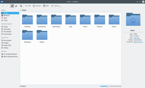

I would suggest downloading on another computer 'Kubuntu' Linux. This is a variation of Ubuntu, but it looks famliar.
http://www.kubuntu.org/getkubuntu/
The user interface looks like if Windows and OS X had an offspring.
You can use a program called 'rufus' to make a bootable USB from the iso download.
