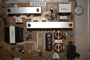

Power board does show significant heat damage.

after disconnecting the led from the power board the tv operated normally (on off button worked) . I put a flash light to the screen and could see picture and sound was working. When I reconnected the led to the power board it started blinking on and off again and the on off button stopped working. Could only turn it off by un plugging from outlet. Bad LED strips. I plan on replacing the power board because it shows alot of heat damage and the LED strips. Cost will probably be around $150.00 with parts from shopjimmy.
