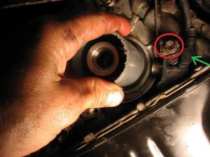

I have been trying to get this car going for about a year.told that the cam sensor is gone and need to replace it.now I'm no expert but I do know that I have watched a few videos on YouTube and where they show the cam sensor to be at it isn't..Then told that it's apart of the distributer shaft.!!!!! So if that's the cam where's the Crank shaft sensor? I ts a no spark issue
@lowvisions , Patrick , On the 2.2l engine, crank position sensor is behind the crank shaft pulley/balancer. Picture below(crank sensor circled). For the V6 3.0l almost same position, see video link. Good luck. I hope this helped you out, if so let me know by pressing the helpful button.

I'm sorry I should of mentioned that I have a 3.0
Patrick, For the V6 3.0l almost same position, see video link. Thanks for replying back.
https://www.youtube.com/watch?v=M6zU6jh8...
On the 2.2 do u have to take the timing cover off to get to the sensor
