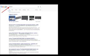

As keyboards are country specific, here is a link to the parts manual for the laptop. Scroll down to Keyboards to find the part number for your keyboard. It is usually also written somewhere on the underside of the keyboard itself. Once you have determined the correct part number, search online using just the part number only to find suppliers of the part. Here is an example to show what I mean. The part number for a USA Chicony keyboard is 04X6101
