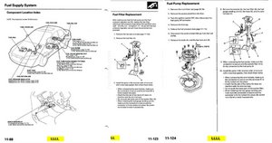

Yall ive been trying for 3 yrs to locate it n haven't found it yet but really haven't looked i shouldn't b having to replace my pump every 6 months to a yr but i have replaced fuel pump relay erg valve all 6 spark plugs n coil packs n i the problem im having is bout every 6 months to a yr it starts giving me problems like the engine isn't getting enough gas to the engine its like when the car runs for a couple of hrs or gets to normal temperature thats when it starts acting up n sometimes want crank even but if u let it sit n cool it will crank right up like theres no problem theres got to b a filter somewhere instead of just that strainer they calling a filter cuz im sick n tired of replacing the pump i have a 2000 honda accord 3.0L 6 cylinder r yall having the same issues

@lo4143uis, Louis, No filter in 1998-2002 Accord in North America, the strainer/sock is in the fuel tank which is not normally replaced attached to the electric fuel pump. the image below shows it attached on the end of fuel pump(yellowy/gold color) Good luck. I hope this helped you out, if so let me know by pressing the helpful button.

Hi @Mary Stone,
Here a composite image from the Accord 1998-2002 CF8 CG3 CG5 CG6 with J30A USDM Factory Service Manual showing the location of the fuel filter.
The image on the left (p.11-88) is from the V6 Supplement Fuel and Emissions section whilst the middle (p.11-123) and right (p.124) images are from the 2/4 Dr Fuel and Emissions section.
The V6 supplement section dealing with the fuel etc only goes to p.106 yet it says in the diagram on p.11-88 to go to p.123 which is in the 2/4 Dr section, so I assumed that the filter would be in the same location for both.
(click on image to enlarge for better viewing)
Hopefully this is of some help.

I’m replacing my fuel pump. I decide to replace everything. The sending unit , fuel pump, fuel filter , wire harness, gaskets and mounting ring. I learned that my 2002 accord 3.0 vtech has a fuel filter. The filter is the large plastic housing that the sending unit, fuel pump, wire harness is attached to. Yes the fuel pump and parts attach to the fuel filter. When you take the fuel pump out of the access hatch in the trunk, those inlet and outlet hoses are going through the fuel filter. It’s not a typical inline fuel filter. Hope this helps. !!!
