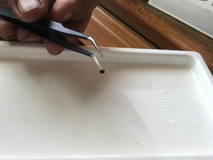

Figured it out.. make sure to heat up before moving front cam and proximity sensor there is a black adhesive that needs to stay on its covers some little gold connectors those need to stay covered so keep it on or put a new black adhesive

I've found the solution ! If a new from camera and earspeaker does not solve the issue remove the front camera and turn it over , you will then see a series of gold pins. On the old screen there should be a black adhesive square that should cover those gold pins, if it is still on the old screen simply place it back on to the camera, if you damage the adhesive , cover it with a piece of tape and color it with black sharpie and that'll do the trick. Tape and a sharpie also works to fix the proximity sensor that doesn't shut off when put up to your ear. You would just put a small piece of tape where the sensor goes and color it black. Works like a charm! Good luck everyone hope this answers and solves your troubles.

I’ve got a picture of the black pad that needed to be transferred, but don’t know how to upload it. Can someone clue me in; so others can see what Edwin was talking about? We transferred it from the old cable to the new, but it had no effect to get my iphone7 earphone or front comparatively working. :(
When I have had this problem, i take it apart and put it back together until it works. Also, if I don't get it right the first time I use a small digital endoscope to make sure everything lines up. This way hasn't failed me yet. Hopefully it won't fail you.
Here’s my pictures of the black insulating pad that might need to be transferred referenced in
Edwin Lopez’s post two posts ago. I put the old cable with the black insulating pad over where the screen was missing the insulating pad. The yellow line shows where the pad needed to be moved to. Hope this clarifies things for folks.

I had a same issue with 7 plus. Really gently take off the flex, heated well or not, black square tape never went in 1 piece with flex, so i take it out later and stick it back to the flex -> no ear speak. After the total mad and about 30h of assembling and disassembling i realized i have been putting the black tape directly to the gold pins under the curved flex. BUT the flex is curved and the black tape should cover the pins and the part of the curved flex as well. I do not know how is this even possible, but this worked for me with 2 x 7 plus, now its worked fine.
