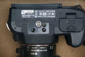

Where is the auto focus adjustment?
where is the auto focus adjustment this guy is talking about?
https://www.flickr.com/groups/83292375@N...

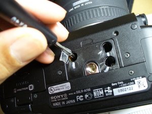

Here is the 3 screws on an A550 and A700, respectively:
The A350 will have the same threw screws. Be sure to follow the advise in this link: http://www.dynaxdigital.com/sony-alpha-c...
