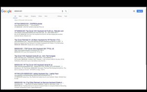

Just search online using the relevant part number only, nothing else, (keyboards are country specific) in the search term, to get results. The part number is also usually printed on the underside of the part as well to confirm which one it is.
Here is an image that shows what I mean. This is for a USA Black cover/keyboard, part #809303-001
(click on image to enlarge for better viewing)
