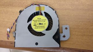

I did open then laptop and removed the fan, i did a research on internet but couldn't find anything.
On the fan there is a sticker with this written on it:
FCN Brushless Motor FFND DC 5v 0.5A
DFS200005090T
I also tried an extensive search for parts to no avail. How about a few closeup pictures of the fan, also if it is the right or left fan. It probably a pretty standard part. Including mm measurements might also help. Would you mind telling us why you think it has failed?

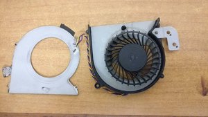

Are you able to remove the fan and the motor from the casing? If so, can you send me a picture of it? I was thinking about replacing the fan with its original casing.
crwdns2944067:012crwdne2944067:0:
Yhea i still have the fan.
I managed to remove the 'casing' but i cant remove the blades from the casing.
If you peel back the forcecon sticker, are there screws to remove the motor? Could you post some additional pictures with the fan disassembled as much as possible? Thanks
I did try to look for the screw , but there is no screw under the sticker

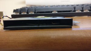

8mm in height 7cm wide and 7cm long. the 'blades' of the fan are about 2.8cm long. the reason why i think it failed is because it started making some 'cruchy' nose when spinning at low speeds, then after 3 months is started making the whole laptop tremble when spinning at high speeds, (dont mind the cable, it got ripped when trying to remove the pin connector since it was glued in by gigabyte)

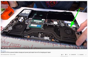

Hi! what laptop is this? p35x v6? is this the CPU fan?

i wrote already the measurements of the fan in my first post. 8mm in height 7cm wide and 7cm long. the 'blades' of the fan are about 2.8cm long.
i tried many times in pulling the blades, but without success, there are no screws either.
