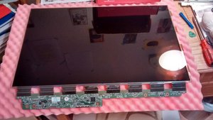

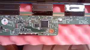

I have taken some pictures of the LCD board and the Chips look alright.
Next week i want to measure the voltage with the oscilloscope, maybe the power supply has a defect ELKO which drops the voltage.

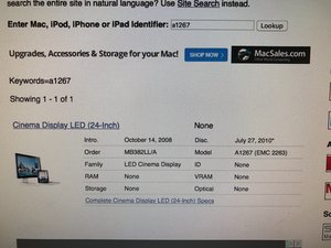

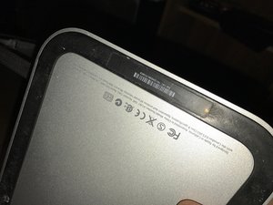

I just fixed a different issue in my 24" CINEMA displaz so I had to dig pretty deep into the display manuals and IC chips on the logic board. Maybe if you send me the exact details of your display, see
http://www.everymac.com/ultimate-mac-loo...
Then I can get an image what device you exactly have.
Can you also take a high precision image of the IC chip side of your logic board, to verify that no chips are burned.
Then if possible try to connect another cable to the Logic board to rule out the cable fault.
PS: ich kann auch deutsch.

So you have exactly the same device as I do. OK. Now,

Check if you have a faint image on the LCD, no backlight?
Did the display work before? or was it dead already when you got it?
Try to lay it horizontal and see if it works.
It sounds little bit like a logic board problem. OR possibly a LCD problem.
So please before anything, inspect the LCD panel PCB board, sometimes the IC there burns.
